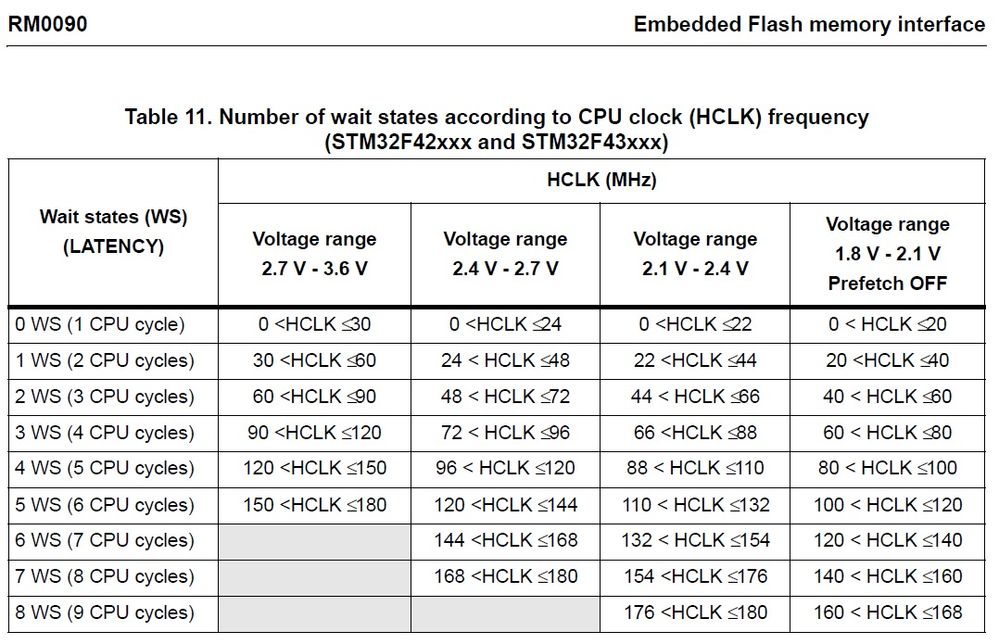

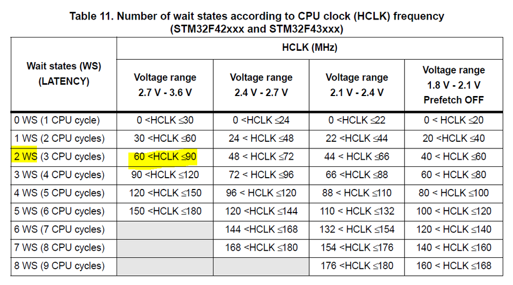

Looks like you should be at 2 wait states. Per the reference manual:

>>(HAL_RCC_ClockConfig(&RCC_ClkInitStruct, FLASH_LATENCY_1)
That's definitely not sufficient for 80 MHz
2020-07-27 3:19 PM
Exactly, I was also looking at the same table at the moment, with your suggestion. Thank you very much TDK!
I will try this and get back to here. For sure this one is a bug here.
