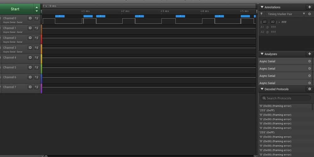

Create a SW4STM32 project using Cubemx. Project in UART, freertos and lwip. I use the task with hal_uart_transmit_it not work.The give a framing error. Added ioc filevoid

Hiyildirim.yi_it,
Try de defined a global buffer and not a local one. And pass a pointer to data buffer in the HAL_UART_Transmit_IT() like following:HAL_UART_Transmit_IT(&huart1, (uint8_t*)buffer, 3);
