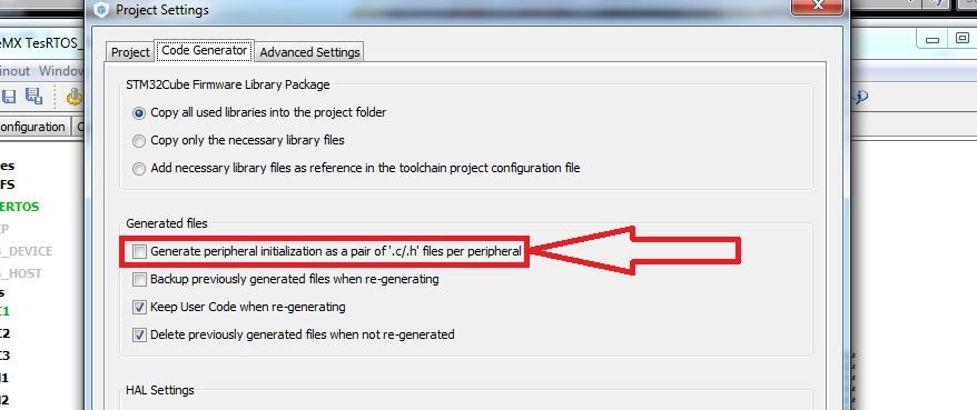

2016-11-27 10:54 AM
if you set the ''separate .c/.h'' switch in prefs, the pin config happens in the peripheral's .c file.

2016-11-28 1:02 AM
So, you mean these one should be left check or uncheck Sir ?
