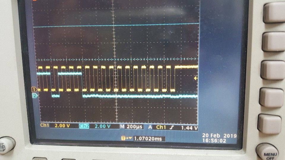

I have no problem with reading the flow sensor. Also there's no problem when reading the pressure sensor when the BLDC motor runs at a low speed. The problem comes when the motor runs at higher speeds: after a while, SDA line is pulled low and there's no way to recover it (I have manually set the GPIO pin high, sent I2C_START/STOP command, or reset the I2C module).

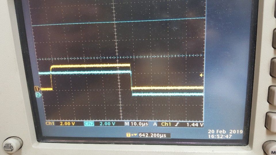

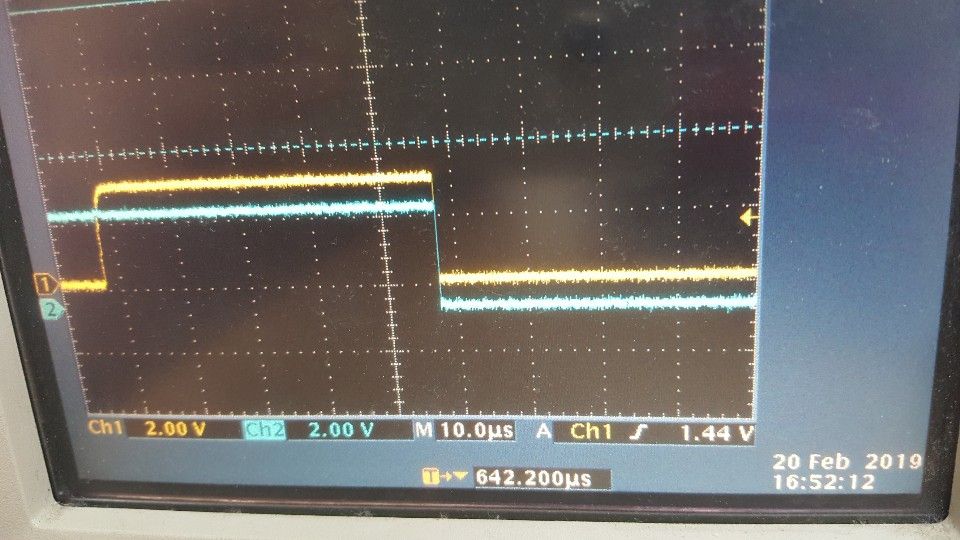

When I zoomed in, it seems that the SDL (blue) is pulled low before the SCL falling edge. This bug always happens after MCU sends the slave address (0x77) when I try to send 0x00 to the pressure sensor. I don't know if it that makes a START condition in the line so the communication was hung or not.

It is strange that it only happens when I send some specific commands such as 0x00 ("Start reading" command). But when I send 0x40 or 0x42 or 0x44 ("Start conversion" command), there was no problem.

Thank you for your prompt reply. The bug happens at a same place. Whenever I send 0x00 command to the pressure sensor, the communication hangs right after the slave address (0x77 or 0b1110111) is sent. As you can see from the picture 1 and 2, the problem occurs the last bit "1" in the SDA line.
