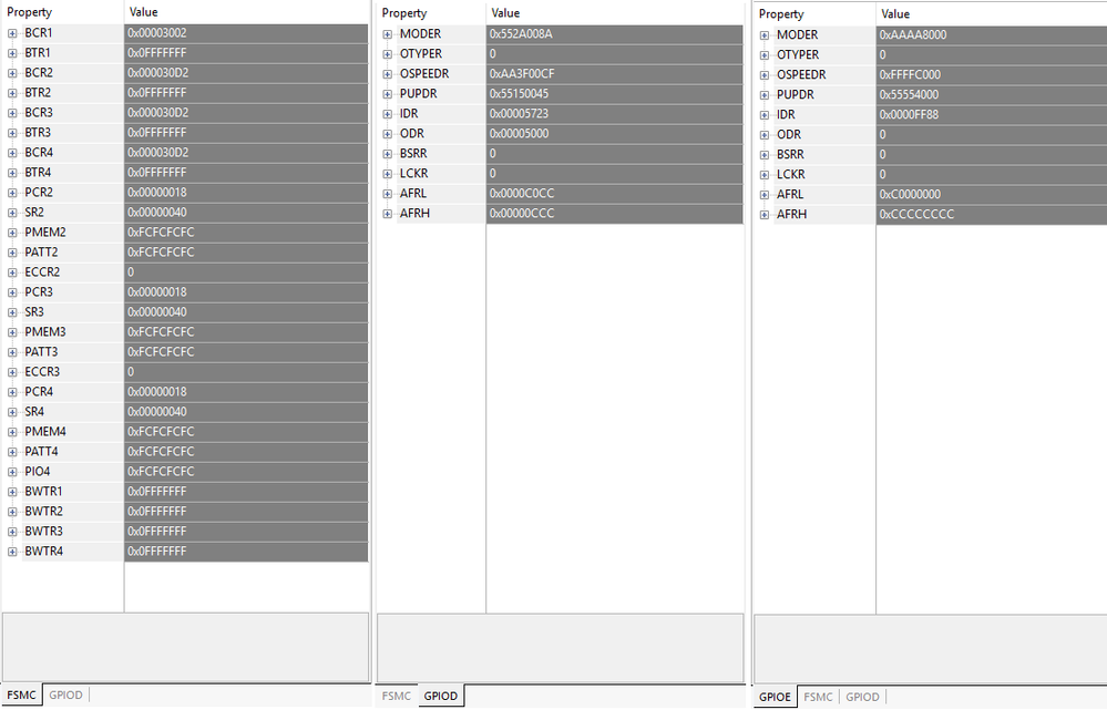

Here is the FSMC, GPIOD and GPIOE registers and their contents.
2016-01-14 7:40 AM
While I wrote ''post register content'', I meant ''look at the registers content and think yourself'' :)
FSMC_BTR1 is uninitialized. I don't ''speak'' SPL nor Cube, but I suspect what you did is not the proper way how the FSMC should be initialized. JW2016-01-14 8:42 AM
Thanks again Jack. Can you give some advice that how to properly initialize the fsmc?
