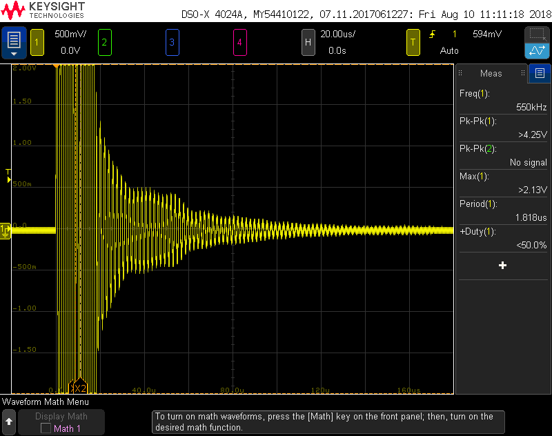

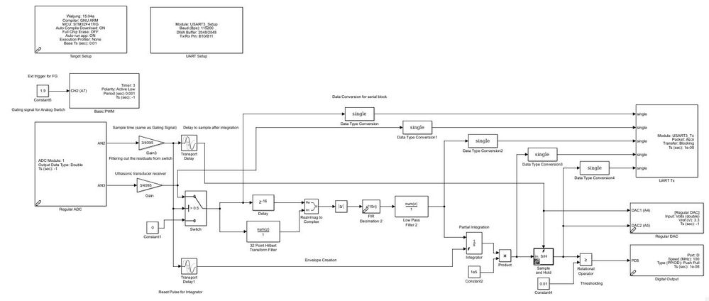

I am trying to do a partial integration on a 550 KHz waveform using STM32F4 Discovery board using the Waijung toolset in Simulink. The sampling time that I am using is 0.018 us, i.e 3 cycles if the clock frequency is 168 MHz. The ADC prescaler is 2, so the ADC frequency is 84 MHz. The total time required for the conversion should be 0.143 us (12 bit resolution) +0.018 us i.e. around 0.16 us. This should theoretically suffice the Nyquist criteria for sampling. However, I dont seem to get any output at the end. I can't see the real time data after ADC, using the serial interface or the DAC. So I am not sure what I am doing wrong. Any suggestions or ideas is much appreciated.
P.S. I am attaching the waveform I am trying to acquire (integration between say 20 us to 140us) and the simulink program. Please let me know if any other information is required.

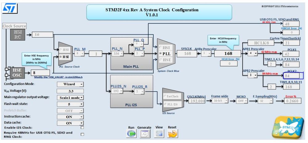

2018-09-20 6:09 AM
According to the clock config file, PCLK2 is 84 MHz by default. So if I consider another prescaler of 2 after this, the frequency would be 42 MHz (the datasheet says Fplck2/prescalar). I understood that the UART or the DAC wouldn't work, but I was trying whatever I could. My main motivation is to get the digital output that I am trying to obtain after the integration of the curve and the comparator. With the 42 MHz frequency this should be at least achievable, isn't it?
