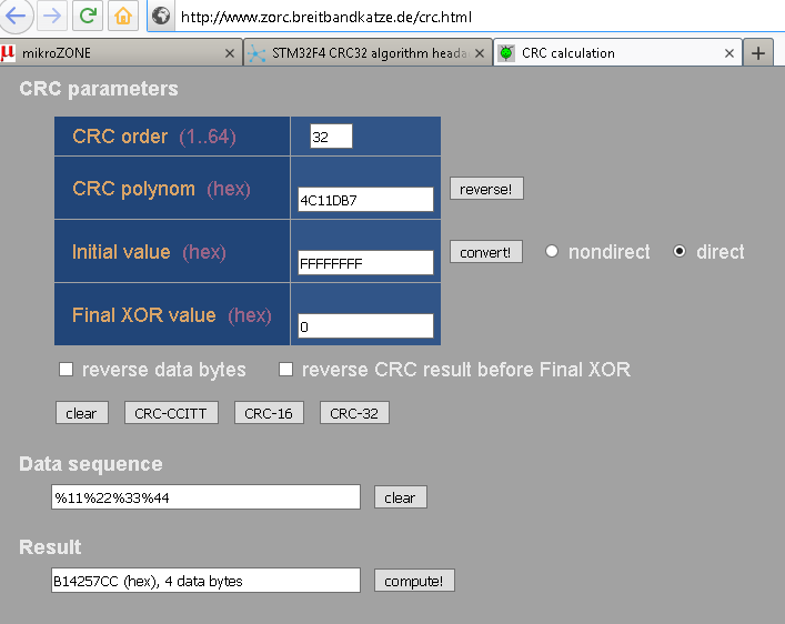

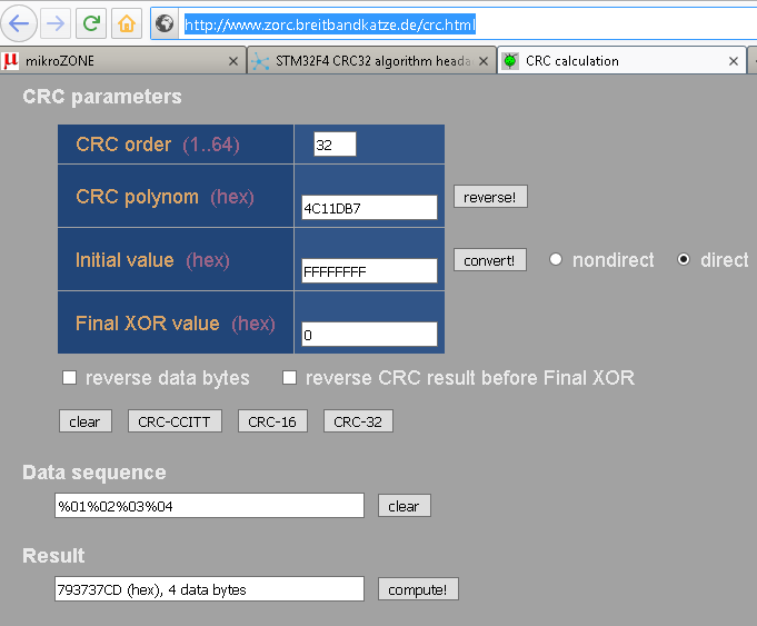

>The source data was simply 0x01020304
>F4's CRC output was: 0xA18723BA
How *exactly* did you produce that?
Besides Clive's program, the srecord package embeds also a STM32 CRC calculation (arguably it's not the easiest to use though). This is my favourite CRC online calculator http://www.zorc.breitbandkatze.de/crc.html with Clive's data (note the tickboxes' settings):
and your data:
One way how to check if your CRC calculation is not completely failed is to append the result to the checksummed data and perform the CRC again; the result should be 0 - this is what Clive did in hist last example.

Awesome, thankyou. Apparently I lost my mind yesterday :)
2019-02-08 2:15 AM
"One way how to check if your CRC calculation is not completely failed is to append the result to the checksummed data and perform the CRC again; the result should be 0 - this is what Clive did in hist last example."
Thankyou, I'd completely forgotten about this!
I was able to prove my CRC function was in error, and then located the fault in fairly short order. (It was a daft typo mucking up the last word of the input data. Yesterday was a no brain day.)
