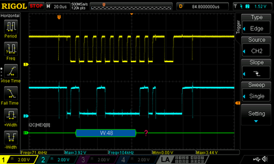

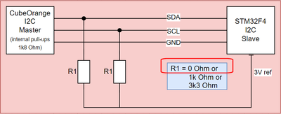

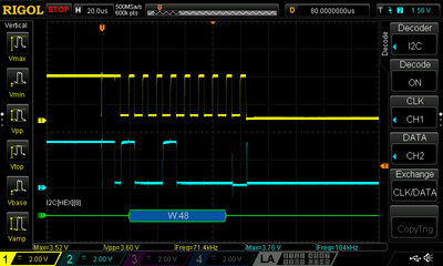

Based on schematics, CubeOrange already have 1k8 Ohm pull-ups placed, so I have connected SCL/SDA lines directly. Connection schematics and results are shown below. In neither of those cases the communication with CubeOrange was successful. I get BERR before it even enter any of the interrupt functions defined in HAL I2C driver.
CubeOrange(Master), STM32F4(Slave), 1k8 Ohm internal pull-ups, R1 = inf Ohm, Rn = 1k8 Ohm
CubeOrange(Master), STM32F4(Slave), R1 = 1k Ohm, Rn = 643 Ohm
CubeOrange(Master), STM32F4(Slave), R1 = 3k3 Ohm, Rn = 1k2 Ohm
I would say there is something wrong on the bus, but what and how to resolve it - this is beyond me right now.

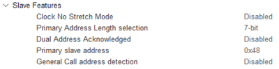

My STM32 slave I2C pin setup is following:
and all interrupts are having same priority levels(pre and sub are both 0, setting max priority for all interrupts).

0-ohm pullups will certainly not work - that's just shorting the lines to the 3V ref!

With 0-ohm, what I meant was there is no additional resistors on the SDA/SCL line, therefore no connection to 3V ref.
As mentioned in my OP, CubeOrange should have internal pull-ups present inside the cube, therefore the

@mr4k wrote:With 0-ohm, what I meant was there is no additional resistors .
That would be an infinite resistance - not a zero resistance!

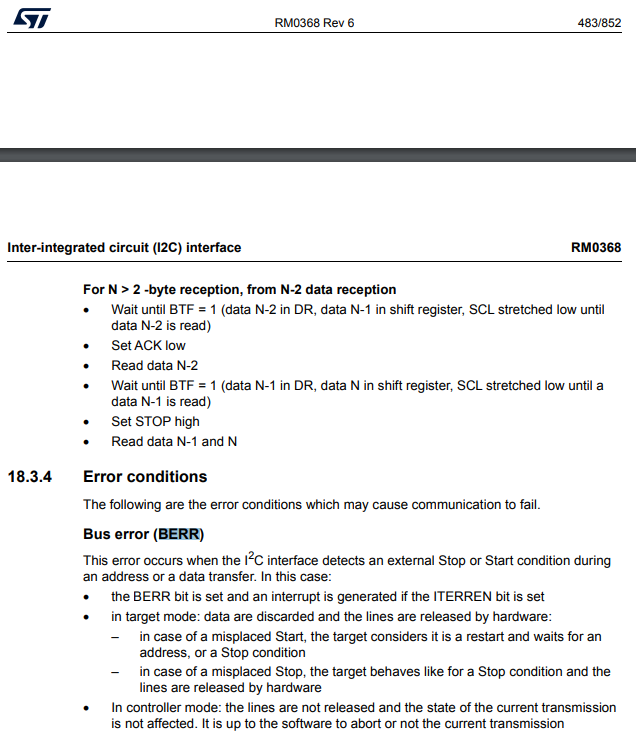

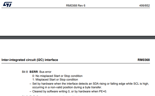

The Reference Manual gives you more specific detail; eg,
Sure, documentation is our friend. However I do not see misplaced Start or Stop condition or am I missing something? I tried to investigate the situation further using debugger but could not find anything useful at this point.
