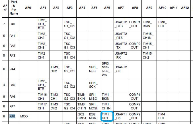

GPIO_PinAFConfig(GPIOA, GPIO_PinSource8, GPIO_AF_12);
AF6 not AF12

ok... that worked, now i've got a signal similar to the one on the F0. THX!
But whats the Difference between#define
GPIO_AF_6
((uint8_t
)0x06)/* IR_OUT, I2S2, I2S3, SPI2, SPI3, TIM1, TIM8 */
and#define
GPIO_AF_12
((uint8_t
)0x0E)/* TIM1 */
or#define
GPIO_AF_2
((uint8_t
)0x02)/* COMP1_OUT, TIM1, TIM2, TIM3, TIM4, TIM8, TIM15 */
or any other GPIO_AF_X with TIM1 in it? There seems to be no other documentation like the one in the code, or i haven't found it yet.But that still won't drive a brushless motor on a BLDC. Any ideas on that?2013-10-04 6:04 PM
You would want the
http://www.st.com/st-web-ui/static/active/en/resource/technical/document/datasheet/DM00058181.pdf
for yourhttp://www.st.com/web/catalog/mmc/FM141/SC1169/SS1576/LN1531/PF252054
2013-10-05 4:29 AM
Ah, thats the table i was expecting to find in the F3Discovery manual ;)
