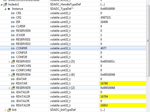

I have some questions below:
1.When finished the SDADC calibration, the offset value will auto add to the result value? or I need to take the offset value from the register "SDADC_CONF0R", and sum with them by myself?
(I have already use the debug mode to check the register "SDADC_CONF0R" , the OFFSET value will update after calibration function, so I think the calibration function is working normally. )
2. No use the calibration function on SDADC, the error percent about 3%, and I use the calibration function, the error percent also about 3% (According to question 1, I think the offset not auto sum with result value), and I try sum the offset value with result value (Accroding to the AN4207 page 11, there talk about offset calibration), but got the error percent about 22% ... , so I think I have some part mistake...
3.The offset value be use minus or add? because the register "SDADC_CONF0R" OFFSET only is positive value, this also confuse me.
Below is my setting:
Differential mode
SDVerf+ : 3 V
SDVref- : GND
Diff+ : 0.75 V
Diff- : GND
I got the AD value (without calibration) 16802, through the formula can get the 0.7691 V.
Please give me some suggest, thank you!!!
