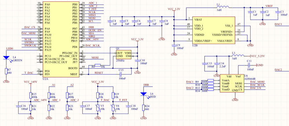

My first suspicion would be hardware - mainly because all you tell us is that (according to you) it is ''sound''. There are many things that you sometimes can ''get away with'' but not if you need things to work first time. Perhaps inadequate power-supply decoupling. Does the F373 have a ''core'' voltage that is internally regulated from your external Vdd; this needs to be decoupled as well as Vdd. Perhaps the decoupling and/or regulation are too far from the processor. Perhaps a dodgy lead from the power-supply to the board. (Do you have an external ''power-supply monitor/watchdog chip that will automatically reset your processor on brown-outs?)

My hardware always have decoupling ( in range of 1uF ) near the pins, and second decoupling goes near LDO. Voltage on each pin are 3.30V and noise is below 10mV.
http://postimg.org/image/r630ynsmd/
