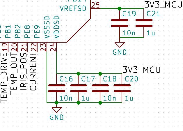

The chip is an STM32F373CBT6, with VREFSD+ and VDDSD both connected to VCC (3.3V). I've followed the ST guidelines on decoupling capacitors, all the caps are on the opposite side of the board (it's only 0.8mm thick) just about as close as I can possibly get them to the pins. Schematic of that section of the board:
