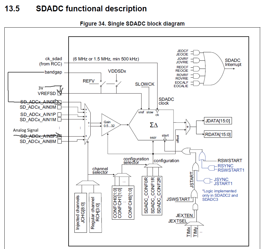

Hi!

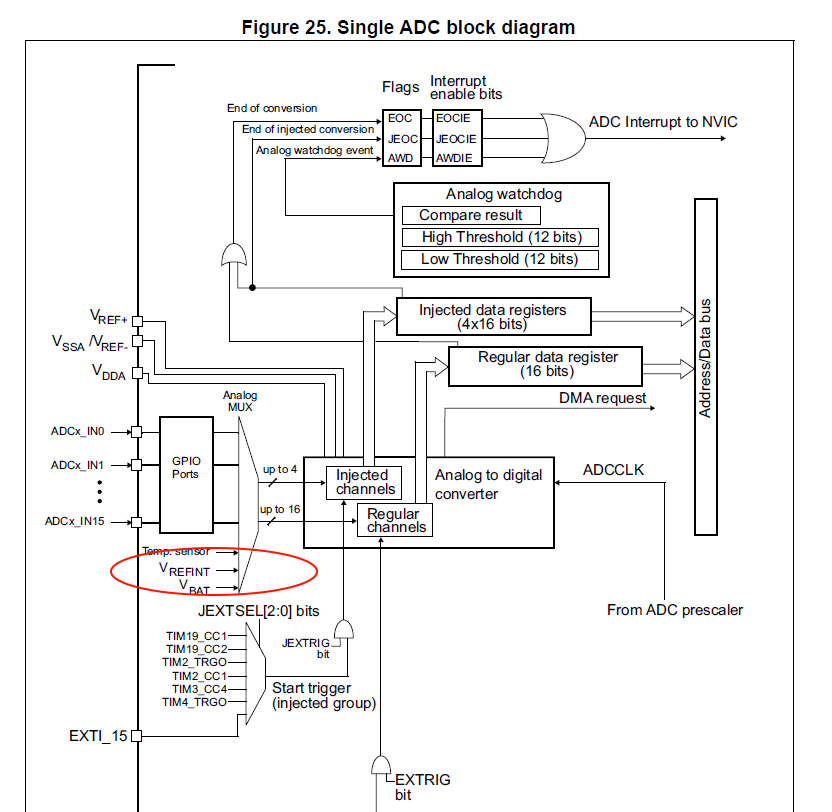

I have been using the F373 and its SDADC successfully for a while now but in my most recent project I'd like to do a precise gain calibration without the use of additional external components. I'm using a 3V external reference voltage connected to VREFSD+. In order to do a gain calibration, I now need to connect another known voltage < 3V to one of the analogue inputs of the same SDADC to measure the gain error. I don't want to buy another reference IC ony for that. So my thought was if it might be possible to connect the unused internal 1.2V bandgap reference signal to one of the SDADC inputs? Basically exactly like it's done for the SAR ADC (Vrefint connected to Analog MUX):2016-02-17 5:00 PM

No one any idea? Impossible? Would be so nice to have!2016-02-21 11:08 PM
Hmmkay, I take that as a ''No''. Not possible. Well then, resistor divider it is.
Hey ST, how about you add that feature to the SDADC MUX for a next hardware revision? Just like for the SAR ADC? That would allow a nice auto-calibration when using VCC or an external voltage as Vref. And this makes much more sense for the SDADC, given its higher resolution ... don't you think?2016-02-22 12:07 AM
