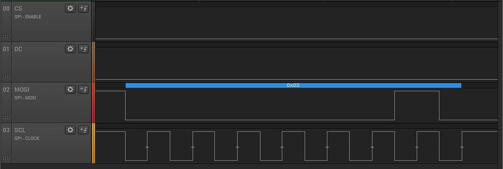

as on Page #35/233, is it using SPI MODE:3 ? Can someone clarify ?
Slightly confused with the timing diagram for the 4 line Serial interface and hence my question.
I am trying to debug an issue that I am facing on the STM32F334 using it with the ILI9341.
Attaching a logic capture of the waveform, on the SPI bus, writing 0x02:
The code that was used to create the waveform:
