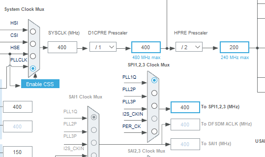

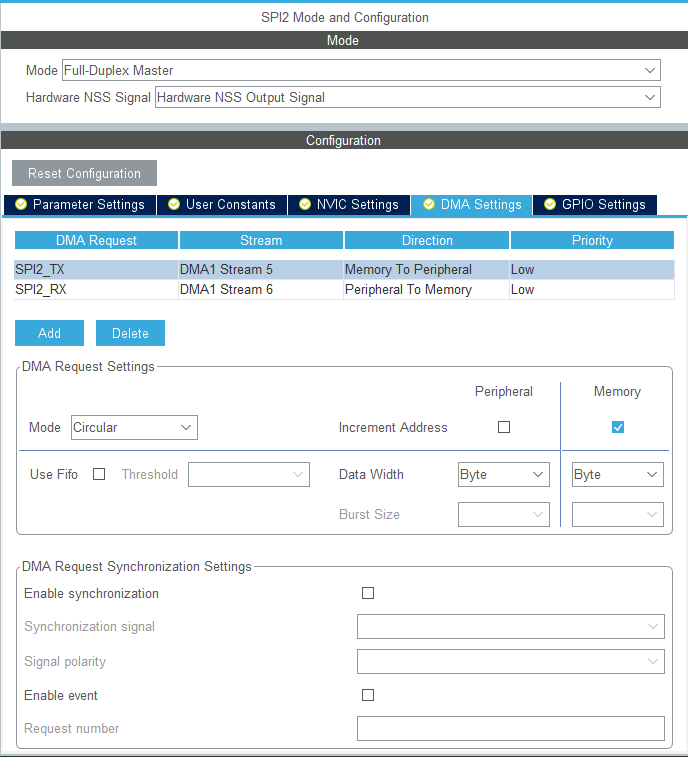

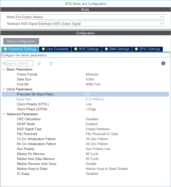

Here are some pictrues:

Toggle a GPIO in the IRQHandler and see if it is saturating there. Perhaps signal on entry/exit so you can see if you're eating too much time in those routines.
Watch for things in your call-back functions which take excessive time, or BLOCK.
For high rates you might want to hand-craft the code with an eye to cycles, interactions, and DMA HT/TC appropriateness.

no NSS means no synchronisation in case of bus glitches occuring.
I would build ADC in a cyclic DMA buffer and use the half/full transfer interrupt to use another DMA channel to push a block of data by SPI.
The SPI throughput (MHz) must be fast enough to flush faster than the ADC fills half buffer.
Toggle NSS to tell this is a new block of data.
SPI Slave should run a cirular mode with same buffer and get interrupt in half/full transfer received, or use EXTI on NSS rise edge to save the incoming block.
