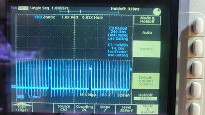

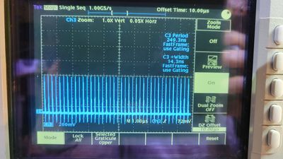

Here are the waveforms for CMP=32 and CMP=31, realize that when lowering the count from 32 to 31 expecting to further narrow the 14ns pulse the huge non linearity caused by some pulse intervals being completely filled
