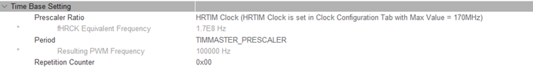

I was struggling to understand why my phase shifted PWM were not working at values below 32 CMP
Im using a stm32g474
I tried to give up to the High resolution and make the HRTIM clock to match System clock (x1 instead of x32)
But im having the same issue,
https://community.st.com/t5/stm32-mcus-products/hrtim-has-minimum-cr-values/td-p/775378
