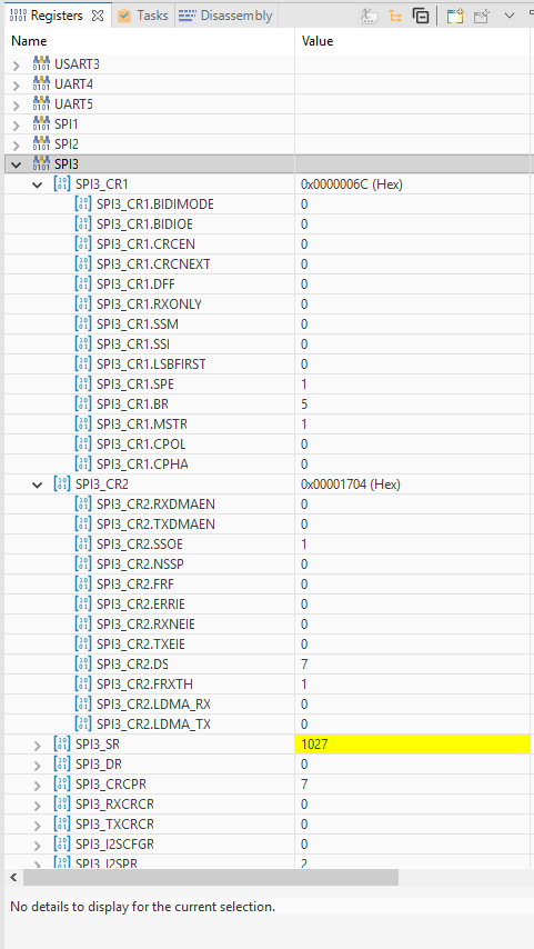

STM32F303ZE Why is my SPI3 module transmitting 16-bits
a b
Associate
Posted on January 22, 2018 at 16:44
I have my SPI3 module configured as a master.  I want it to transmit 8-bit words.  Here is my setup as read from the chip while its executing.  No matter what I do each time I write to SPI3->DR it transmits 16-bits what can I do?  Please don't give any answers involving the HAL libraries as I am not able to use it.

Posted on January 22, 2018 at 17:21
Write to the register with an appropriate cast so the bus transaction has the right width.
*((uint8_t *)&SPI1->DR) = 0xAA;
Posted on January 22, 2018 at 17:22
*((volatile uint8_t *)&SPI1->DR) = 0xAA; // volatile will be safer from the compiler folding the write
Posted on January 22, 2018 at 17:29
And the explanation is under Data packing subchapter in the SPI chapter of RM.
Posted on January 22, 2018 at 17:32
Thanks Clive, works great now.
