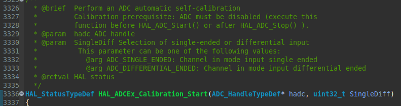

I am using stm32f303re nucleo board, I apply a voltage of 3.3 volts directly to the adc2_in2 analog pin of the stm32f303 microcontroller. My adc resolution rate is 12 bits and the value I read is around 3975. this causes me to get wrong results, why does it do this? Why can't I read properly with the 446re but not the 303?

Did you perform ADC calibration as outlined in the RM?
2023-05-15 3:02 AM
How do i calibrate?
2023-05-15 4:53 AM - edited 2023-11-20 5:31 AM
call ->
is this :
2023-05-15 6:45 AM
it is work. thank you so much.
