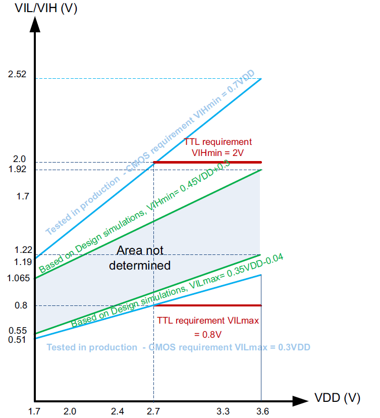

Dears,
we confirm it. There is no contradiction. we test all our devices at factory before we ship to customers at 0.7*VDD; However we give design guidelines based on simulations and so we relax a bit the worst case testing. It is a matter of Guarantee we provide to end customers.
Here is a picture for illustration on STM32F4 series, but similar as other products to understand what means the Guarantee we provide.
Cheers,
STOne-32
