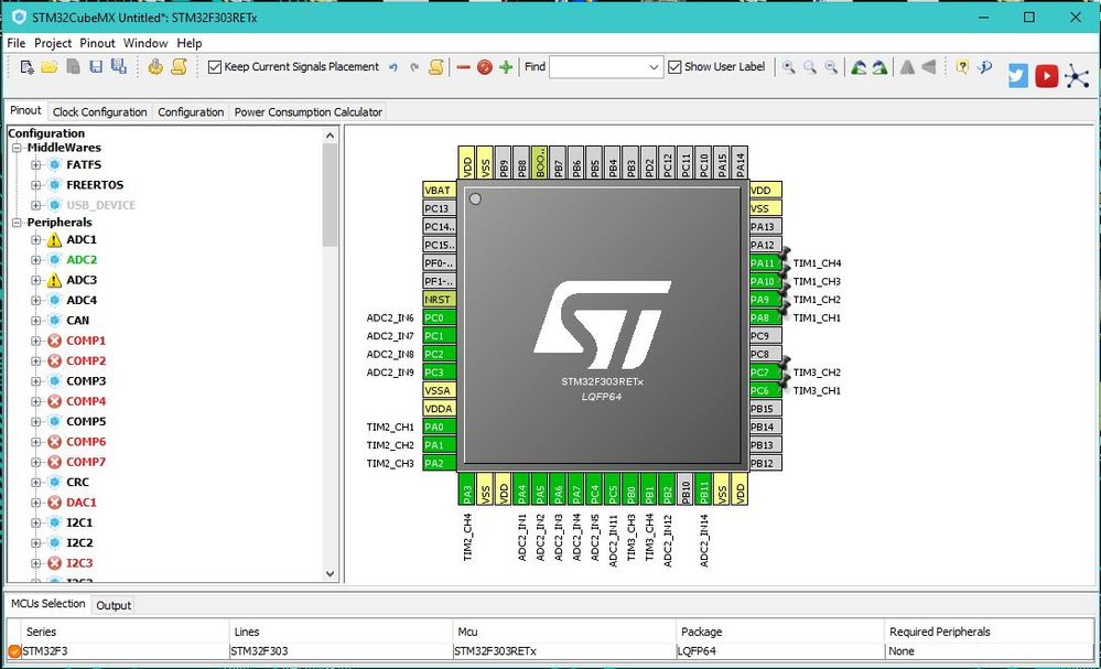

Posted on July 24, 2017 at 10:49
Hello!
Here is one of the posible configurations you asked
Produced by
https://my.st.com/content/my_st_com/en/products/development-tools/software-development-tools/stm32-software-development-tools/stm32-configurators-and-code-generators/stm32cubemx.html
.  There are examples inside how to use timers as PWM generators.
Also examples to take your feedback from valves as ADC inputs.
