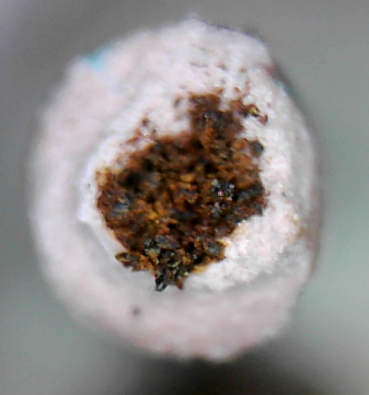

2017-05-29 9:33 PM
Hi Clive,
Yes, that was the hardware!
It is what happens when you buy cheap pre-crimped wire for testing. One of the wires had rusty iron instead of copper...
The code on the first post works fine.
I have attached a close look of the wire below...
