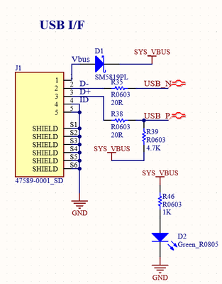

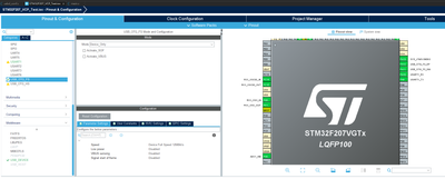

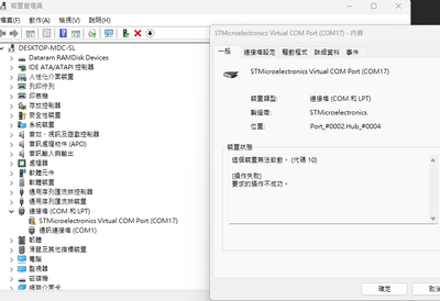

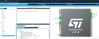

At present, I use a circuit board designed by myself, using STM32F207VGT6. Initialize the VCP function using STM32CubeIDE. But there was a phenomenon that it couldn't solve. Error Code10 displayed on Windows.
Attached is my circuit diagram and the settings of CubeIDE(Only initial setting without any code add or modified)
Where would this be causing the problem? Please give me some advice, much thanks.

Hi. Code 10 means that Windows has successfully detected the device. The USB enumeration and all the descriptor reads are done and the device driver has been started. But then the driver saw something that it does not like. it can be additional descriptor, request or data read (or missing) from some endpoint. Happy debugging!

First, the value of R39 does not correspond to the USB specification. Second, the F2 series have an integrated pull-up resistor.

Hi Pavel A.
Thank you very much for your kind reply. In my design, I am not using ID PIN (It connected to GND) and without the activate VBUS sense, will this cause any problem?

Would you please give some advice? I have remove the R39, but it still can't work.

Hi Piranha
Thanks for your kindly reply. I have removed the R39, but the phenomenon has not changed.

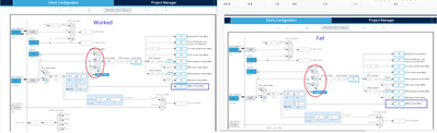

I've solved this problem, but the solution was that I clicked the wrong CLOCK setting when I was too tired. (almost closes eyes). Guess what? After compiling and downloading the firmware, this problem was solved.
I don't know why this would cause this to fail. Have you ever found this problem?

Step 1: Refer to the clock settings in my last reply.
