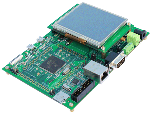

The problem you talked about already exsits in STM32F1xx series MCUs. There is a new method to solve the problem for STM32F2xx series MCUs. You can use DMA to transfer the I2C data. I have done it well onhttp://www.armkits.com/product/devkit1asp
board. I enclose the software example for your reference.2011-12-11 11:39 PM
