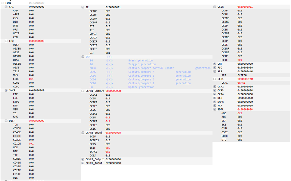

Post the content of timer registers.
JW2016-11-28 10:17 AM
Sorry for the delay, I didn't have the board by my side for a few days...
Here is the content of the TIM1 registers right before enabling the timer2016-11-28 11:30 AM
> CCDS 0x01
Don't. Bit 3 CCDS: Capture/compare DMA selection 0: CCx DMA request sent when CCx event occurs 1: CCx DMA requests sent when update event occurs JW2016-11-28 11:33 AM

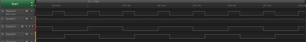

2016-11-28 2:04 PM
excellent observation :)
thanks, it works now... btw CCDS basically excludes triggering DMA transfer on CC and Update which means that one can't trigger two different streams with one timer? For example if I would like to trigger two DMA transfers, one on the falling end and the other on the rising edge of a PWM (CC and Update) is it feasible with one timer? Doesn't look so...We’re moving the ST Community to a new platform to give you a better and more reliable community experience.
