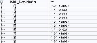

this is what i get om USBH_DataInBuffer 0690X000006039yQAA.jpg 15663103 sectors with 512 bytes each =7.46gb, thats right but i see it as 3724 because it is too big for 32bits addressing. Is there a fix for this limitation?, any tip?. would it work if i create a partition under 4gb? We need only 100mb of the usb space, but the problem is that customers can put any kind of usb-stick, it is not easy to find actually usb sticks under 4gb, and force them to create a partition under 4gb when they are normal users is not a nice thing. Thanks in advance

I have fixed the displaying of drive capacity with
DebugString(''> File System initialized.
Debugprintf(''> Disk : %u sectors
'', USBH_MSC_Param.MSCapacity);
Debugprintf(''> %d sector size
'', USBH_MSC_Param.MSPageLength);
Debugprintf(''> Total: %u Mb
'', USBH_MSC_Param.MSCapacity/1024*USBH_MSC_Param.MSPageLength);
But it is a detail... really cant work with current 2.2.0 version properly since

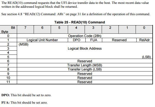

Checking this document (
http://www.usb.org/developers/docs/devclass_docs/usbmass-ufipdf
) from usb.org 4.7 READ(10) Command: 28h 0690X00000603A3QAI.jpg it is a 32 bits pointer... , limitation is in read10 command

Posted on July 18, 2016 at 15:12
READ(10)/WRITE(10) have a 32-bit *BLOCK* address, this equates to 2TB
The problem in most ST code is the use of 32-bit *BYTE* addressing, and the unnecessary conversion back-and-forth between BYTE and BLOCK numbers related to BLOCK storage media.
