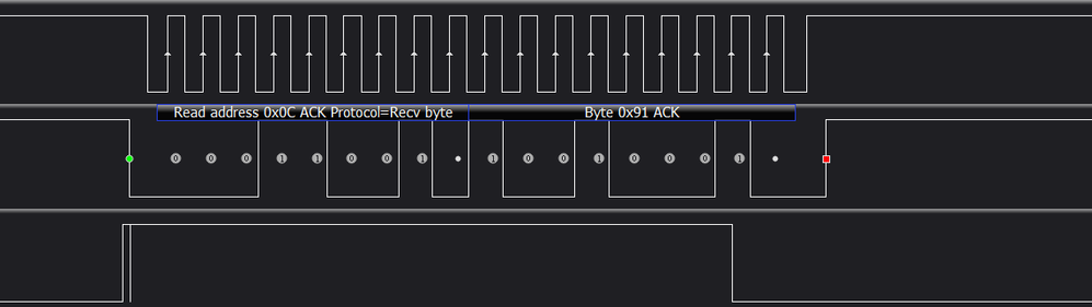

I recheck my slave address 0x48, as TDK said the slave address left-aligned(0x90). smbus clock is 100khz. I2C_SendData(I2C2,addr) failed, the smbdata line sholud be low,but no changes.

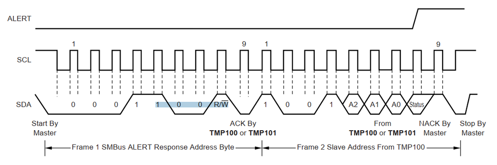

hi ,
about the SMBus Alert response , gotta dizzy. could u tell the timing? as the smbhost send 0x18 or 0x19 gotta no ack
2022-01-25 6:47 PM
Hey,
Thankyou for the slience, i gotta it.
smhost to request the slave addres & status when the alert pin active.
