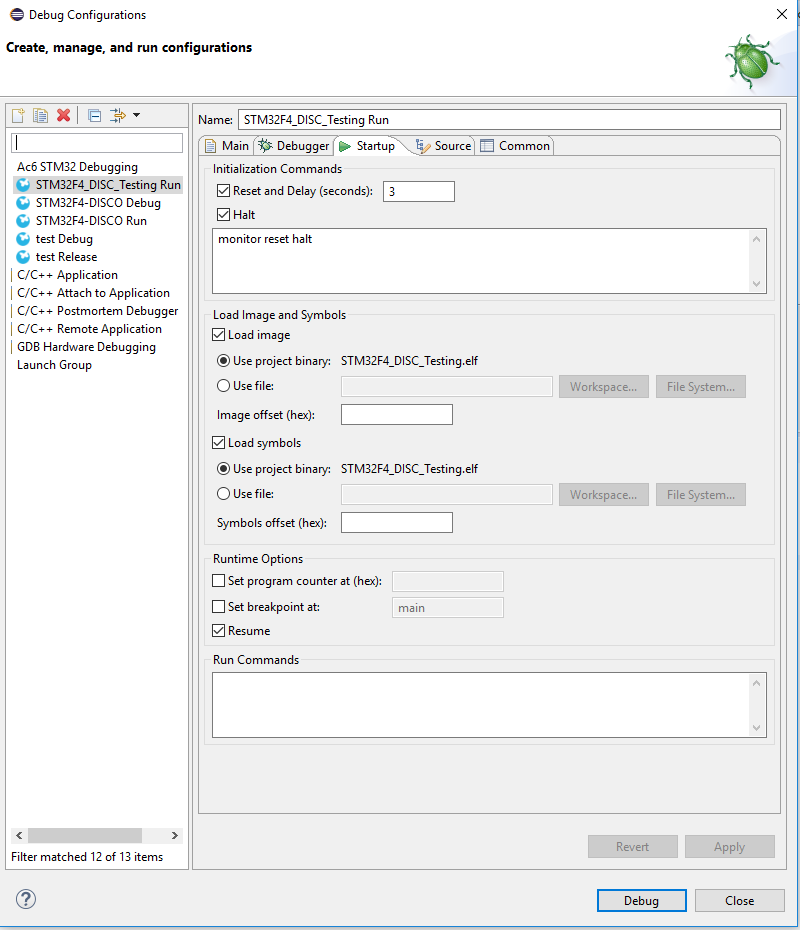

Thanks, but after this I still have the same error. I removed all breakpoints and removed the initial default breakpoint. Also, I've attached mystartup settings in my debug configuration.

The target is halted due to startup reset, which should be fine. I prefer not to enable 'Reset and Delay', 'Halt' nor 'Resume', but I'm not entirely sure of their relevance.
