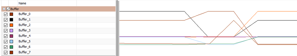

I have DMA setup to read 8 channels of the ADC into a fixed buffer and I'm having an issue where after an extended period of time (usually hours) the ADC channels are read into the wrong buffer index. The failure usually results in the destination index shifting back 1 from the correct index for a small amount of time (<100ms), and then the destination index shifts forward 1 from the correct index for an extended period of time (a couple of minutes). After that the issue seems to heal itself. I have the readings sent out over CAN in a 20ms periodic message and can observe the failure there.
This is high level view of the failure where you can observe the indexes switching.
This is a zoomed-in view of the point in time where the failure occurs.

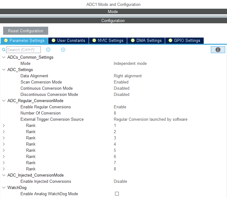

The ADC and DMA settings are configured in Cube IDE.
The relevant generated code in main.c is:

* @brief ADC1 Initialization Function
* @param None
* @retval None
static void MX_ADC1_Init(void)
/* USER CODE BEGIN ADC1_Init 0 */
/* USER CODE END ADC1_Init 0 */
ADC_ChannelConfTypeDef sConfig = {0};
/* USER CODE BEGIN ADC1_Init 1 */
/* USER CODE END ADC1_Init 1 */
/** Common config
hadc1.Instance = ADC1;
hadc1.Init.ScanConvMode = ADC_SCAN_ENABLE;
hadc1.Init.ContinuousConvMode = DISABLE;
hadc1.Init.DiscontinuousConvMode = DISABLE;
hadc1.Init.ExternalTrigConv = ADC_SOFTWARE_START;
hadc1.Init.DataAlign = ADC_DATAALIGN_RIGHT;
hadc1.Init.NbrOfConversion = 8;
if (HAL_ADC_Init(&hadc1) != HAL_OK)
Error_Handler();
/** Configure Regular Channel
sConfig.Channel = ADC_CHANNEL_9;
sConfig.Rank = ADC_REGULAR_RANK_1;
sConfig.SamplingTime = ADC_SAMPLETIME_239CYCLES_5;
if (HAL_ADC_ConfigChannel(&hadc1, &sConfig) != HAL_OK)
Error_Handler();
sConfig.Channel = ADC_CHANNEL_3;
sConfig.Rank = ADC_REGULAR_RANK_2;
Error_Handler();
sConfig.Channel = ADC_CHANNEL_7;
sConfig.Rank = ADC_REGULAR_RANK_3;
Error_Handler();
sConfig.Channel = ADC_CHANNEL_8;
sConfig.Rank = ADC_REGULAR_RANK_4;
Error_Handler();
sConfig.Channel = ADC_CHANNEL_14;
sConfig.Rank = ADC_REGULAR_RANK_5;
Error_Handler();
sConfig.Channel = ADC_CHANNEL_15;
sConfig.Rank = ADC_REGULAR_RANK_6;
Error_Handler();
sConfig.Channel = ADC_CHANNEL_6;
sConfig.Rank = ADC_REGULAR_RANK_7;
Error_Handler();
sConfig.Channel = ADC_CHANNEL_4;
sConfig.Rank = ADC_REGULAR_RANK_8;
Error_Handler();
/* USER CODE BEGIN ADC1_Init 2 */
/* USER CODE END ADC1_Init 2 */
}The DMA is started periodically in software and observed after the transfer complete callback is called.

2021-10-02 8:08 AM
I would try configuring two GPIOs as outputs, place SET/RESET in different places and analyze on 2 channel scope is there any congestion. Or you can see if problem goes away if you change compiler settings to "optimize for speed". If problem goes away with this configuration it may indicate some blocking problems, when some areas of code run much longer time that you would imagine.
Another possibility is that somehow one DMA sample is lost. I observed such problem when used maximum sampling rate and a lot of DMA1 transfers (ADC in circular+DAC+UART simultaneously). In some cases UART DMA transfer shifted ADC DMA received buffer by one sample. Problem was solved by disabling ADC external trigger and moving UART to DMA2. Note that in my case ADC was continuously running in circular mode, so there was no any "self healing" and lost samples count accumulated over time as UART data was sent to the computer.
And less likely it may be the problem on the monitoring software side, the one which shows those graphs. If you still have this problem I need to see how Task_ADC() is used, and how I2C DMA or other peripherals with DMA are called.
