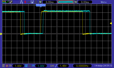

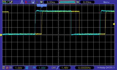

2024-05-14 3:46 AM
As @waclawek.jan suggested:
I observed the waveforms of the rotary decoder. (see images: clockwise/anticlockwise)
the waveform look as expected.

Observe waveforms on the two input pins using oscilloscope or logic analyzer. Or, read out and vizualize the GPIOx_IDR register, on which the two input pins are located.
Is the waveform as expected, i.e. with 90deg. phase shift in one direction and -90deg in other?

2024-05-14 3:46 AM
