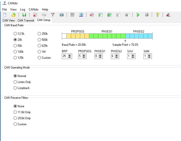

2018-04-25 6:29 PM
I used the CanDo unit for a week. everything worked brilliantly with the code I have already given you.
here are the sample points required by CanBus
2018-04-26 12:43 AM
Okay so ...
For some reason, it seems that the different Time Quantas my Peak USB likes to receive are different than what
GONZALEZ.Laurent
mentionned. I managed to find this out while searching a bit in the submenu of PcanView.So now it seems to be working ...
