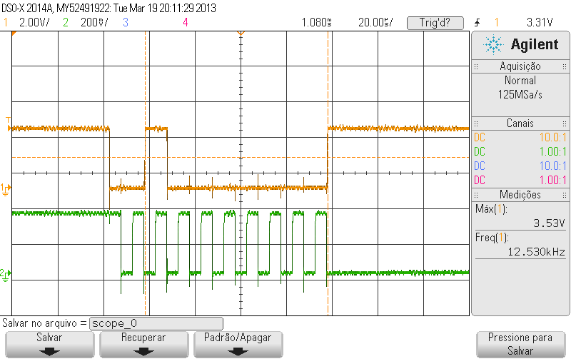

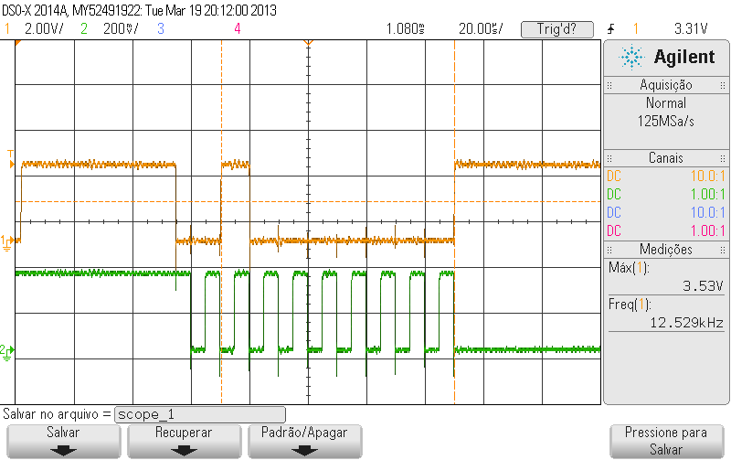

I am trying to comunicate with MCP23016 by i2c and i am using STM32F103RB with uVision 4. The problem is that if I send 0x40 is the same if I send 0x41. Its the red mark on the code. My code is:void I2C_Configuration(void)

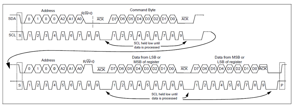

Thats what mcp23016 needs.
