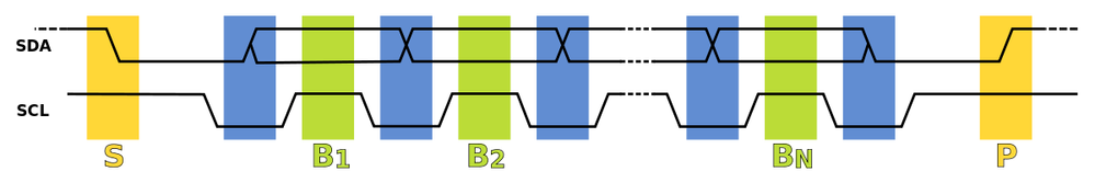

BERR signifies an unexpected start or stop condition, per the reference manual.
Can you use a logic analyzer to show what's happening on the line? How do you know it's incorrect behavior?

I can't see anything that would explain BERR in the scope plots. The NACK on the last byte makes sense as you're only receiving 2 bytes. It will NACK the last byte in order to stop the transaction.

That sequence anyway should not lead to BERR in this case. Actualy i found out what is going on. The logic that drives BERR flag in uC is really sensitive to SDA to SCL hold time which can be 0 as per specification. In my case I can't exactly say wether this was violated to negative value (if so, definitely not more than -20 ns) but this was enough to catch wrong START or STOP condition. As soon as my I2C master is FPGA project I increased this hold time to approx less than 50 ns and that was enough to make it work stable. Many thanx for Your help.

After looking back at the plots, I can see now that SDA changes state very close to the SCL falling edge. Probably SDA changes state before SCL on one or more of them which is in fact a misplaced start or stop condition. The logic analyzer should catch this, but if the edges are close or overlapping, perhaps the correct logic isn't in the analyzer software.
