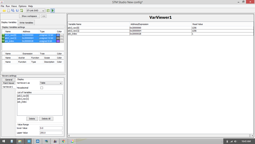

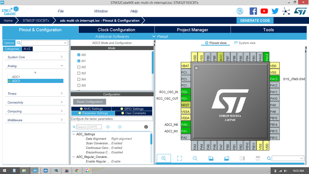

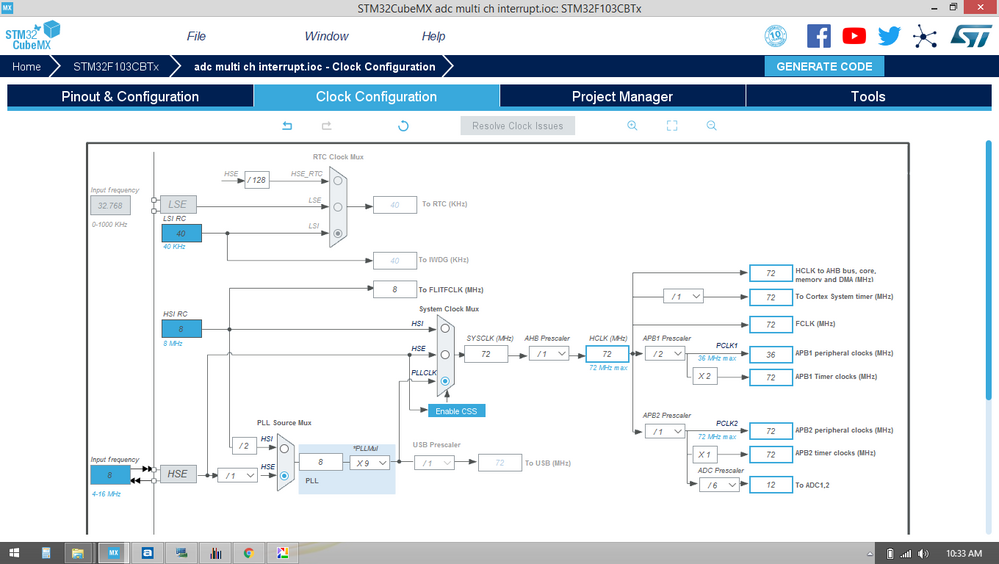

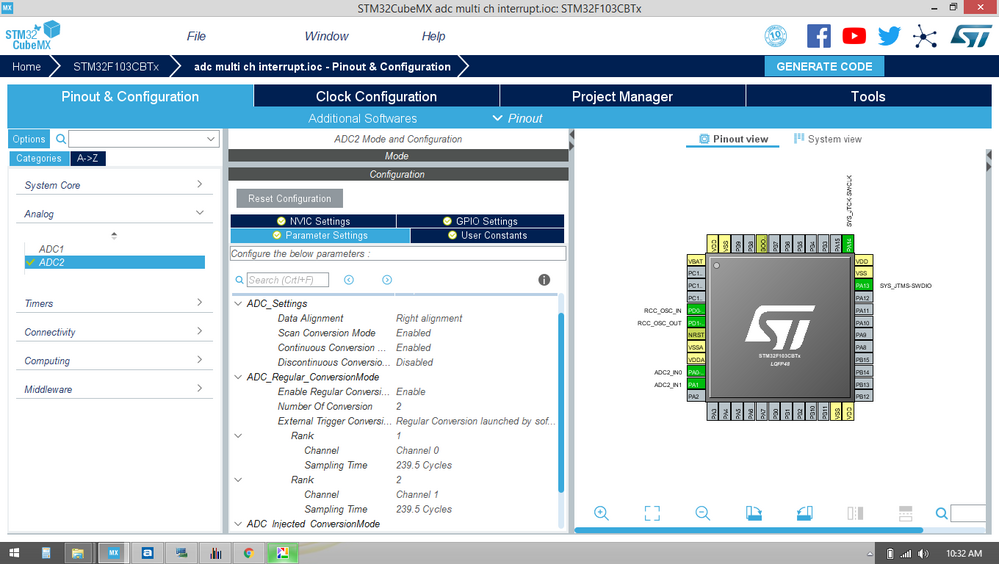

2019-04-10 10:15 PM
/* USER CODE BEGIN Header */
* @file : main.c
* @brief : Main program body
* @attention
* <h2><center>© Copyright (c) 2019 STMicroelectronics.
* All rights reserved.</center></h2>
* This software component is licensed by ST under BSD 3-Clause license,
* the "License"; You may not use this file except in compliance with the
* License. You may obtain a copy of the License at:
* opensource.org/licenses/BSD-3-Clause
/* USER CODE END Header */
#include "main.h"
#include "adc.h"
#include "gpio.h"
/* USER CODE END Includes */
/* USER CODE BEGIN PTD */
/* USER CODE END PTD */
/* USER CODE BEGIN PD */
/* USER CODE END PD */
/* USER CODE BEGIN PM */
/* USER CODE END PM */
/* USER CODE BEGIN PV */
uint32_t adc2_raw[2];
uint8_t adc_index = 0;
/* USER CODE END PV */
/* USER CODE BEGIN PFP */
/* USER CODE END PFP */
/* USER CODE BEGIN 0 */
void HAL_ADC_ConvCpltCallback(ADC_HandleTypeDef* hadc)
/* Prevent unused argument(s) compilation warning */
//UNUSED(hadc);
if(hadc->Instance == ADC2){
if(adc_index == 0){
adc2_raw[0] = HAL_ADC_GetValue(&hadc2);
++adc_index;
}else {
adc2_raw[1] = HAL_ADC_GetValue(&hadc2);
adc_index = 0;
/* USER CODE END 0 */
* @retval int
int main(void)
/* USER CODE BEGIN 1 */
/* USER CODE END 1 */
HAL_Init();
/* USER CODE BEGIN Init */
/* USER CODE END Init */
SystemClock_Config();
/* USER CODE BEGIN SysInit */
/* USER CODE END SysInit */
MX_GPIO_Init();
MX_ADC2_Init();
/* USER CODE BEGIN 2 */
HAL_ADC_Start_IT(&hadc2);
/* USER CODE END 2 */
/* Infinite loop */
/* USER CODE BEGIN WHILE */
while (1)
/* USER CODE END WHILE */
/* USER CODE BEGIN 3 */
/* USER CODE END 3 */
* @retval None
void SystemClock_Config(void)
RCC_PeriphCLKInitTypeDef PeriphClkInit = {0};
/** Initializes the CPU, AHB and APB busses clocks
RCC_OscInitStruct.HSEPredivValue = RCC_HSE_PREDIV_DIV1;
RCC_OscInitStruct.HSIState = RCC_HSI_ON;
RCC_OscInitStruct.PLL.PLLMUL = RCC_PLL_MUL9;
Error_Handler();
RCC_ClkInitStruct.APB1CLKDivider = RCC_HCLK_DIV2;
RCC_ClkInitStruct.APB2CLKDivider = RCC_HCLK_DIV1;
if (HAL_RCC_ClockConfig(&RCC_ClkInitStruct, FLASH_LATENCY_2) != HAL_OK)
Error_Handler();
PeriphClkInit.PeriphClockSelection = RCC_PERIPHCLK_ADC;
PeriphClkInit.AdcClockSelection = RCC_ADCPCLK2_DIV6;
Error_Handler();
/* USER CODE BEGIN 4 */
/* USER CODE END 4 */
* @retval None
void Error_Handler(void)
#ifdef USE_FULL_ASSERT
* @param file: pointer to the source file name
* @param line: assert_param error line source number
* @retval None
/* USER CODE BEGIN 6 */
tex: printf("Wrong parameters value: file %s on line %d\r\n", file, line) */
/* USER CODE END 6 */
#endif /* USE_FULL_ASSERT */
/************************ (C) COPYRIGHT STMicroelectronics *****END OF FILE****//**
* File Name : ADC.c
* Description : This file provides code for the configuration
* of the ADC instances.
* @attention
#include "adc.h"
ADC_HandleTypeDef hadc2;
/* ADC2 init function */
void MX_ADC2_Init(void)
ADC_ChannelConfTypeDef sConfig = {0};
/** Common config
hadc2.Instance = ADC2;
hadc2.Init.ScanConvMode = ADC_SCAN_ENABLE;
hadc2.Init.ContinuousConvMode = ENABLE;
hadc2.Init.DiscontinuousConvMode = DISABLE;
hadc2.Init.ExternalTrigConv = ADC_SOFTWARE_START;
hadc2.Init.DataAlign = ADC_DATAALIGN_RIGHT;
hadc2.Init.NbrOfConversion = 2;
if (HAL_ADC_Init(&hadc2) != HAL_OK)
Error_Handler();
/** Configure Regular Channel
sConfig.Channel = ADC_CHANNEL_0;
sConfig.Rank = ADC_REGULAR_RANK_1;
sConfig.SamplingTime = ADC_SAMPLETIME_239CYCLES_5;
if (HAL_ADC_ConfigChannel(&hadc2, &sConfig) != HAL_OK)
Error_Handler();
sConfig.Channel = ADC_CHANNEL_1;
sConfig.Rank = ADC_REGULAR_RANK_2;
Error_Handler();
void HAL_ADC_MspInit(ADC_HandleTypeDef* adcHandle)
if(adcHandle->Instance==ADC2)
/* USER CODE BEGIN ADC2_MspInit 0 */
/* USER CODE END ADC2_MspInit 0 */
/* ADC2 clock enable */
__HAL_RCC_ADC2_CLK_ENABLE();
__HAL_RCC_GPIOA_CLK_ENABLE();
/**ADC2 GPIO Configuration
PA0-WKUP ------> ADC2_IN0
PA1 ------> ADC2_IN1
GPIO_InitStruct.Pin = GPIO_PIN_0|GPIO_PIN_1;
GPIO_InitStruct.Mode = GPIO_MODE_ANALOG;
/* ADC2 interrupt Init */
HAL_NVIC_SetPriority(ADC1_2_IRQn, 5, 0);
HAL_NVIC_EnableIRQ(ADC1_2_IRQn);
/* USER CODE BEGIN ADC2_MspInit 1 */
/* USER CODE END ADC2_MspInit 1 */
void HAL_ADC_MspDeInit(ADC_HandleTypeDef* adcHandle)
/* USER CODE BEGIN ADC2_MspDeInit 0 */
/* USER CODE END ADC2_MspDeInit 0 */
/* Peripheral clock disable */
__HAL_RCC_ADC2_CLK_DISABLE();
HAL_GPIO_DeInit(GPIOA, GPIO_PIN_0|GPIO_PIN_1);
/* ADC2 interrupt Deinit */
HAL_NVIC_DisableIRQ(ADC1_2_IRQn);
/* USER CODE BEGIN ADC2_MspDeInit 1 */
/* USER CODE END ADC2_MspDeInit 1 */
/************************ (C) COPYRIGHT STMicroelectronics *****END OF FILE****/We’re moving the ST Community to a new platform to give you a better and more reliable community experience.
