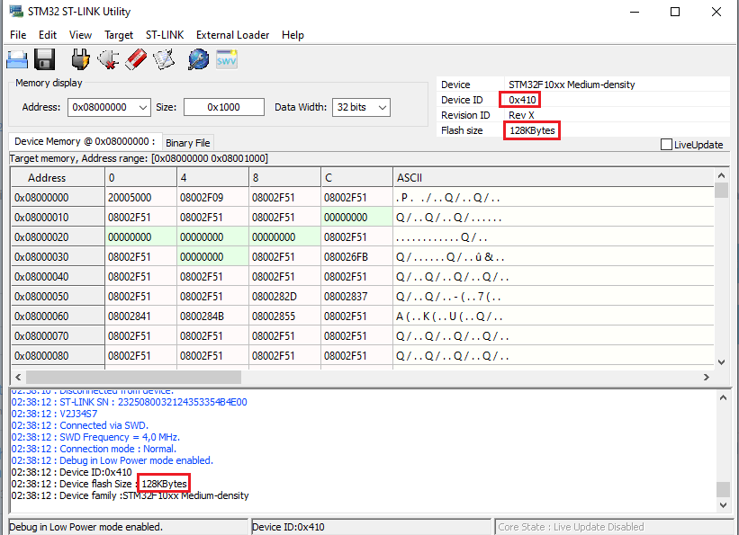

Here is a screenshot from the STLink utility when connecting the 128k board:

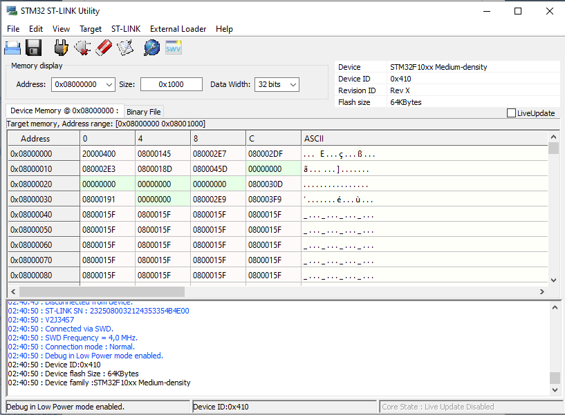

And here is a utility when connecting a normal board:

STM32F103x8 and STM32F103xB are the same chip. So the 128k flash are on chip. On a STM32F103xB, the upper 64 kB are fully tested, on a a STM32F103x8 the flash is probably not tested or was tested bad. So if you play with a a STM32F103x8, you can try to use the upper flash. But do not rely on that flash to work right!
