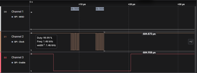

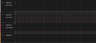

I tried to use Logic Analyzer I just bought to see how it's going and actually it seems it still generated a clock using Receive Only Master, but somehow it just loops on this call HAL_SPI_TransmitReceive(&hspi1, &dummy, data, 2, HAL_MAX_DELAY) != HAL_OK and keep generating clock then when I debug it I just can't get over that line
But using hspi1.Init.Direction = SPI_DIRECTION_2LINES; (Full-Duplex Master) it works I can get over that HAL_SPI_TransmitReceive line. The logic is also seems to be correct
