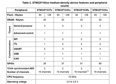

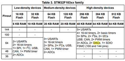

Only high-density STM32F103 devices have a DAC. The STM32F103x8 is medium-density.

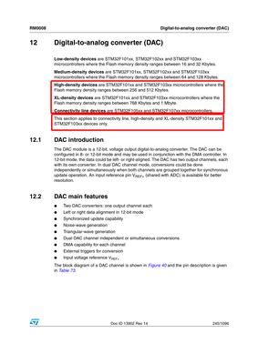

take a look at the ds --- might help.
2023-07-27 3:23 AM
2023-07-27 3:24 AM
Thanks. So I will have to sort out to PWM in this case. Changing the horse is not an option momentarily.
