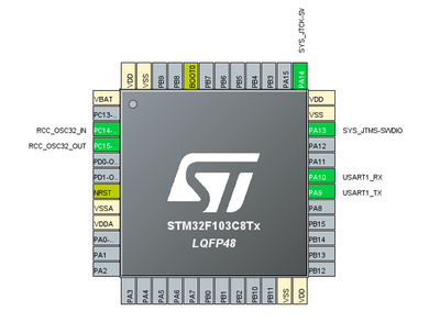

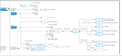

2024-10-14 9:10 PM
Hi @Imen.D
I believe I have configured the LSE correctly. I've attached screenshots of my CubeMX configurations for your review. Since I don't have a coin cell available, I'm currently supplying Vbat with 3.2V from another Nucleo board, while the ST Blue Pill is powered via the STLink V2 programmer.
I’ve noticed that when Vbat is powered and I remove Vdd, the contents in the backup register remain intact when I reconnect Vdd. However, the RTC is not functioning properly.
Additionally, when Vbat is supplied, I measure 2.2V across Vdd. Is this expected behavior?
