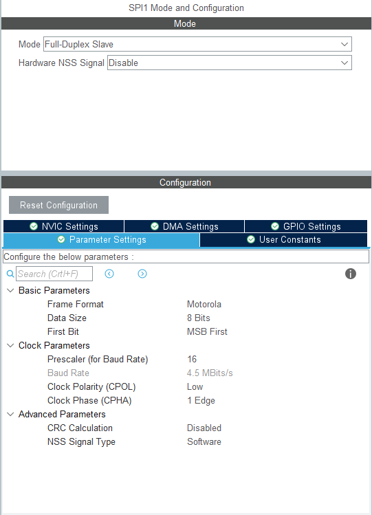

Is there an explanation to this behavior? the SPI configuration is as follows:

2022-02-08 4:05 PM
Thanks, now transmission works, but the function HAL_SPI_TransmitReceive_IT is not triggering HAL_SPI_RxCpltCallback nor HAL_SPI_IRQHandler do you know how can I trigger an interrupt using HAL_SPI_TransmitReceive_IT?
