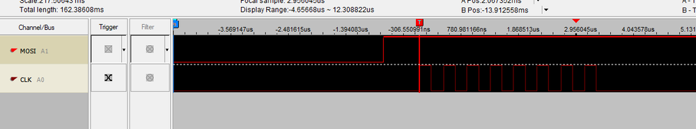

I try to run SPI 1 on STM32F103C8 but when i send data i have only SCK signal. MOSI(PB5) is in high state (dont change).
SPI2 on PORTA works grate.

2023-02-02 6:37 AM
Yes I check this at first time.
HAL_GPIO_WritePin(GPIOB, GPIO_PIN_5, RESET);
HAL_GPIO_WritePin(GPIOB, GPIO_PIN_5, SET);
works ok (whene SPI1 is disabled)

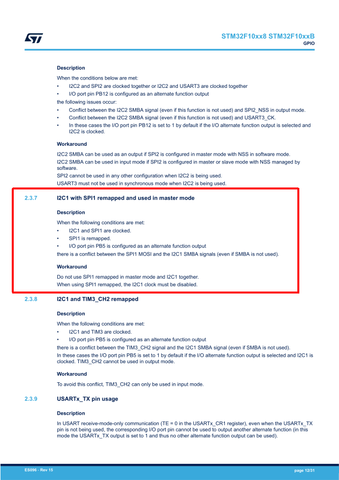

2023-02-02 2:19 PM
Ok
I found out what is causing the problem.
you can't have I2C1 enabled with SPI1 even if I2C1 pins are remapped
any way to bypass this problem?
2023-02-03 2:03 AM
Probably not in an easy way.
If you use I2C as master, you can try to bit-bang it.
You can consider using a different pin-compatible STM32.
