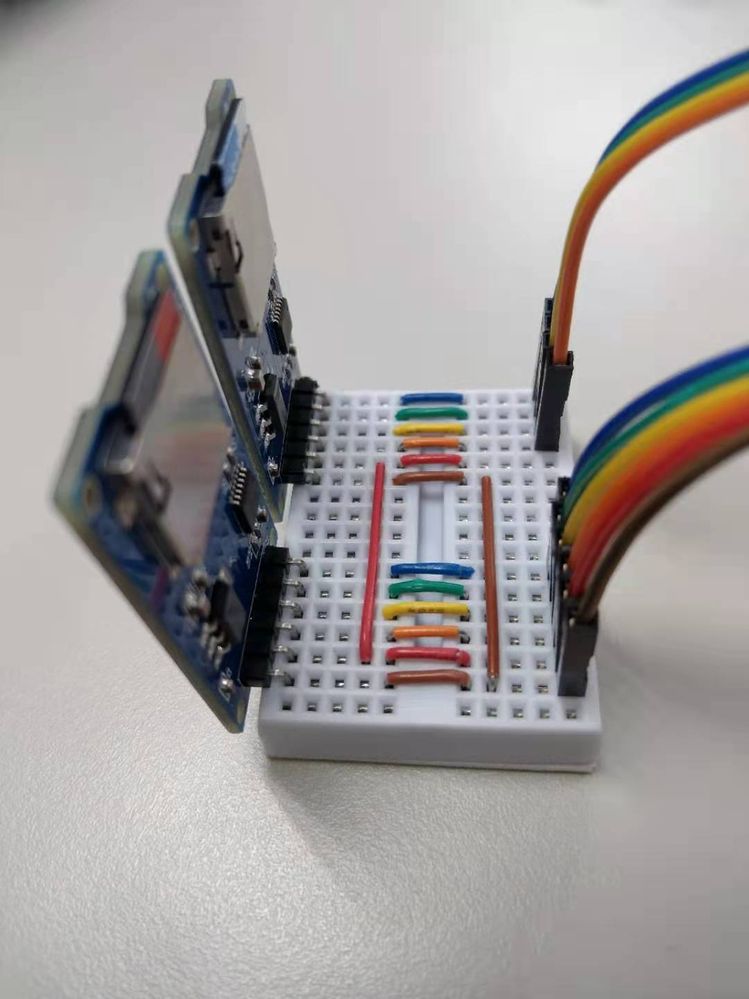

Hello, I have succeeded in accessing (r/w) an SD card with STM32F103C8 blue pill and a microSD adapter using SPI in a master/slave configuration. Now I want to go to the next level by using 2 SD cards in a master / multiple slave configuration.
According to documentation I should have one separate slave select pin (SS or CS) for each SD card and the rest of the pins shared ( VCC, GND, SCLK, MOSI, MISO).
I know how to change CS when working with one slave, now my question is: when there are multiple slaves what should I do with the rest of the CS pins so the do not interfere while working with one card ? Should I keep them always high, always low or should they be changed to the opposite level as the one I am working with?
Thank you guys for your help

2021-10-14 8:35 PM
I have tried but it failed to initialize any of the SD card. Do you think there might be some electrical interference as I connected them directly without adding other electronic component or the problem is more likely to be at a software level ?

2021-10-14 10:22 PM
Thank you I will try speeding down the clock. Because after I connect the second SD card, the first one isn't able to initialize anymore even if I keep CS2 high all the time. Separately each SDC work fine.
2021-10-15 12:36 AM
@migmel did you checked if the MISO of the not selected SD card remains high impedance?
https://hackaday.com/2014/11/25/better-spi-bus-design/
*neat wiring by the way, very fancy
2021-10-15 2:04 AM
That is something I haven't check yet, the MISO tri-state condition. I already could initialize the first SDC by setting CS2 low during initialization process, the problem now looks physical: Sometimes i get FR_NOT_READY, sometimes FR_NO_FILESYSTEM.
2021-10-18 11:23 PM
Hello, I finally succeeded. You were right about keeping CS of unused SD Cards high. I think the problem was with the SDC adapters. I was using adapters compatible with Arduino and they have this LVC125A chip and a 5V power input(so I had to use a 5V external power source). I replaced them with another adapters non Arduino compatible that don't have the LVC125A chip and have a 3.3 V power input( So I just connected one of them directly to MCU ports) and it worked nicely.
