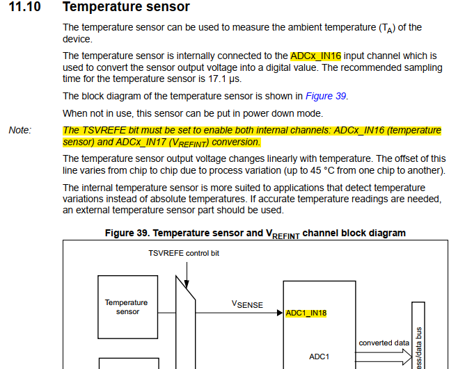

reading the ref manual of the STM32F103C8, it says in chapter 11.10 that the temp sensor is internally connected to ADCx_IN16. In figure 39, it says that the temp sensor is connected to ADC1_IN18.
I reckon that this is a simple typo, or do I miss anything fundamental here? However, I could not find this information in the errata sheet.
If it's a typo, what's the correct ADC channel then?

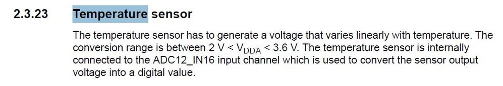

0693W000006FeqLQAS.jpgHello,
This is from DS.

Every indication is that it's channel 16.
https://github.com/STMicroelectronics/STM32CubeF1/blob/master/Drivers/STM32F1xx_HAL_Driver/Inc/stm32f1xx_hal_adc.h#L306 :
#define ADC_CHANNEL_TEMPSENSOR  ADC_CHANNEL_16  /* ADC internal channel (no connection on device pin) */
Still ought to be corrected in the RM (which is now in its 20th revision).
@Imen DAHMEN​ can this plese be placed into the pipeline. Thanks.
Thanks @Vangelis Fortounas​ , @Community member​  for pointing out this typo.
I raised this internally to correct the RM0008 in the coming release.
