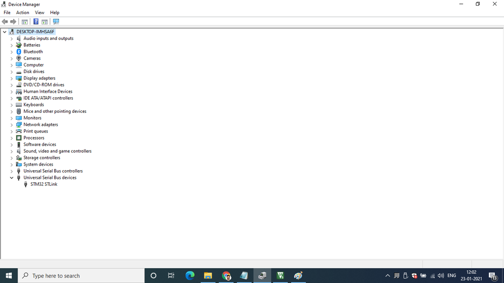

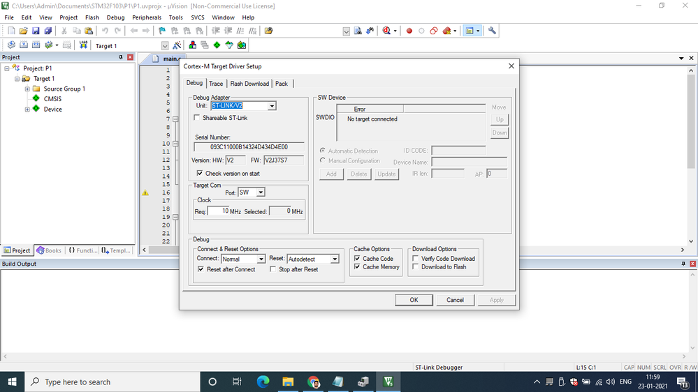

I had installed required drivers for STM32F103C in my PC and also I had installed necessary packages in keil IDE and Arduino IDE. I am not able find out the problem.
I am using ST-Link V2 i have made a proper connection with STM32F103c board.
Below I have attached Device manager picture and keil ide picture after connecting the board to PC. Kindly help me out as soon as possible

Hello
Is the device powered? (led)
SWDIO-SWCLK-GND are mandatory to connect. Suggest to connect also and NRST pin. and "Connect: Under Reset" in debug tab.
Use also STLink Utility to connect with device.
2021-01-25 8:55 AM
Authentic ST-LINK/V2 or bootleg/clone?
The authentic one needs VTarget power connected.
Perhaps try with the STM32 Cube Programmer to see if that recognizes it.
The device must be powered and functional.
Is this a custom board? Has it worked before?
Can you perhaps provide a wiring diagram, and an in-focus, high resolution, picture of the setup?
