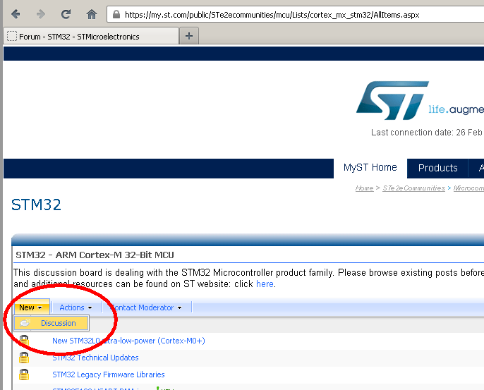

> hello admin, how can I post a question on this forum?
