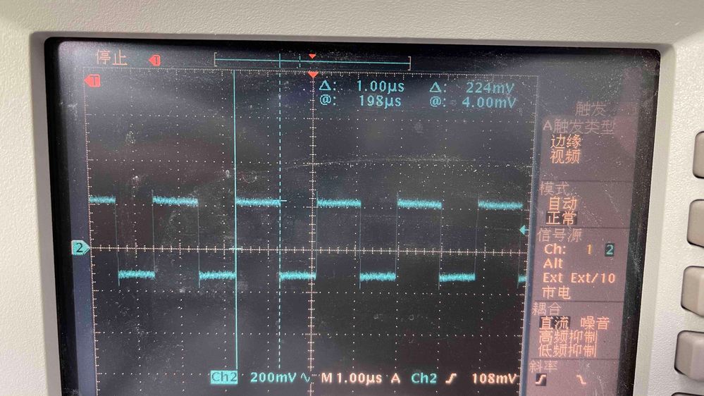

I use STM32F103CB in my project. but I found timer interrupt fastest time can't less than 1us.
Timer prescaler is 0, up counter mode, counter period is 36, no inernal clock division and auto-reload enable. When timer interrupt occur. I set Pin high and low in turn. But the output time from the pin is 1us.

I've just realized that we are talking us not ms. And that means that this simply may be the case of the ISR taking too long to execute/unrealistically high interrupt rate.

I don't use Cube/HAL and don't quite understand those statements. They appear to do what you intend - system clock 72MHz, APB1 = AHB/2 thus TIM clock = 2x APB1 = 72MHz - but the presented result contradict that.
Output system clock onto MCO pin and check if it is 72MHz as you expect.
Or try to run exactly the same code without using PLL, running at the internal 8MHz RC oscillator, and check the output waveform at that rate - is it 9x slower than with PLL?
Read out and check/post the RCC and TIM registers content.

1 microsecond is pretty fast but, if that is about all you need to do, to toggle a bit, then that should work OK. I don't know how fast this processor is though.
What I would do is to use a TIMER output to do this work. Then you won't need to use the processor time.

Thank you for your reply. I found the gotcha ISR taking too long to execute when you reply 2 days ago.

I use STM32F103CB and work at 72MHz.If use timer interrupt to output a square wave the fastest frequency is almost 1MHz.
