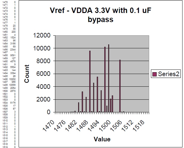

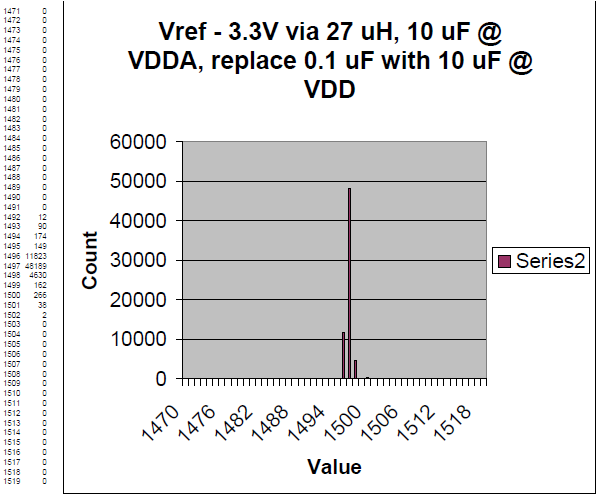

Considerable progress - added 27 uH 0805 inductor in series between VDD_1/2/3 and VDDA, modest improvement in distribution of the samples was seen. Then changed the decoupling cap between VDDA and ground from 0.1 uF to 10 uF (ceramic 0805 6.3V) and saw a dramatic improvement. Finally changed 0.1 uF decoupling cap near VDD_1 from 0.1 uF to 10 uF, and saw a further modest improvement in distribution of samples. Lesson learned - can't take the value of decoupling caps in this area for granted!
Reading Vref 65k times with 239.5 sample time and 12 MHz ADC clock
First plot is after changes (MCU now has 10 uF @ VDD_12 to ground; VDDA supplied by same 3.3V source, but with 27 uH series inductance followed by 10 uF @ VDDA to ground).
Second plot is before changes (VDDA tied to VDD_1, 0.1 uF at both pins to ground)

ST appnotes suggest 1uF//10nF parallel combination to VDDA-VSSA. Series inductance can help. But ADC "noise" highly depends on external conditions, like quality yours 3.3V supply, grounding scheme etc.
Yours results with 27uH, looks nice. I don't believe it can get any better.
