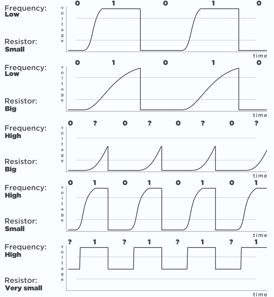

2022-07-01 2:07 AM
"an oscilloscope is probably better, as you can see any analogue nasties - such as wrong pullup values"
For example:
