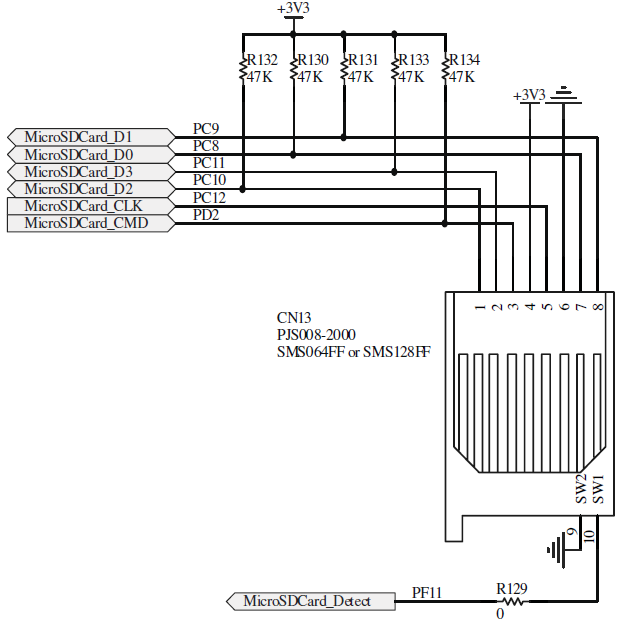

What board are you using? Can you draw a schematic of the socket connectivity? What cards are you using MMC, SD, SDHC, MicroSD, etc? What capacity? What low level software are you using to access the cards? Some ST Library? Yes, you should verify the low level SD access functions before integrating FatFs on top. Check the pin configurations, and SD_Init() code. Check if the 1-bit access mode at 400 KHz is actually working and pulling device geometry from the card.2014-05-19 11:29 PM
Hi Clive and thanks for the reply.
I'm using an STM32F103VE in a custom board (attached there is the schematic for the SD connection). I'm using 2 different cards with the same specification: SDHC 4GB class 4. The low level software used for access the card is sdcard.c fromMCD Application Team of STMcivroelectronics. This is the GPIO configuration: GPIO_InitTypeDef GPIO_InitStructure; /* GPIOC and GPIOD Periph clock enable */ RCC_APB2PeriphClockCmd(RCC_APB2Periph_GPIOC | RCC_APB2Periph_GPIOD, ENABLE); /* Configure PC.08, PC.09, PC.10, PC.11, PC.12 pin: D0, D1, D2, D3, CLK pin */ GPIO_InitStructure.GPIO_Pin = GPIO_Pin_8 | GPIO_Pin_9 | GPIO_Pin_10 | GPIO_Pin_11 | GPIO_Pin_12; GPIO_InitStructure.GPIO_Speed = GPIO_Speed_50MHz; GPIO_InitStructure.GPIO_Mode = GPIO_Mode_AF_PP; //(GPIOMode_TypeDef)(GPIO_Mode_AF_PP | GPIO_Mode_IPU | GPIO_Mode_Out_PP); GPIO_Init(GPIOC, &GPIO_InitStructure); /* Configure PD.02 CMD line */ GPIO_InitStructure.GPIO_Pin = GPIO_Pin_2; GPIO_Init(GPIOD, &GPIO_InitStructure); In fact, inside theSD_Init(), the functionSD_PowerON() method returns ''SD_CMD_RSP_TIMEOUT'' when it sendsCMD8 to verify SD card interface operating condition.The SD_CLK clock is about 370KHz. How can I test the sd low level software before integrate it in the FatFS code? Thank you very much. ________________ Attachments : SD_schematic.png : https://st--c.eu10.content.force.com/sfc/dist/version/download/?oid=00Db0000000YtG6&ids=0680X000006HzD2&d=%2Fa%2F0X0000000bLc%2FhjNc8nN0Ij8jGccEZjX2hE3R_yQ.56Q0YrVsG6xWipk&asPdf=false2014-05-20 5:34 AM

My STM3210E-EVAL has a MicroSD card wired as follows.

Hi Clive
thanks for the answers.At the end the problem was only the SD card connector (form Molex) whose pins were not good contact when the card was inserted.Thanks for advice.2014-09-28 11:31 AM
