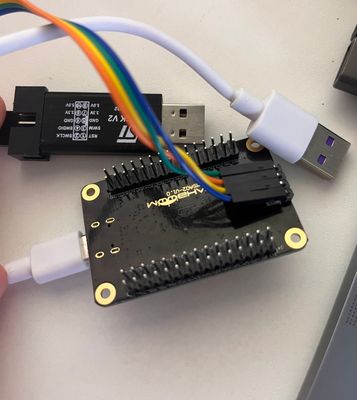

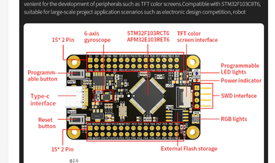

yes, this imu sensor is on the board. I don't have any wiring on board. Do I need it? Do I need to check signals? the board is new, and I run another code on it without issue.

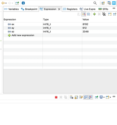

I only see these. , ax - ay- az

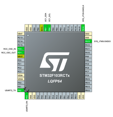

So you have data and you're trying to send over huart2. So how is UART2 connected to the outside world? What are you using to view this data? Baud rate match both ends?

Again, you've shown you have data. I'm trying to see your issue with
I can't see something on my serial port.
So how are you connecting the UART2 to the outside world, in this case the STM32CubeIDE console?
2024-10-14 9:24 AM - edited 2024-10-14 9:25 AM
UART2 is routed through the st-link interface to the usb port. Am I correct? @Karl Yamashita
