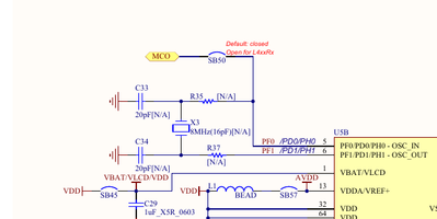

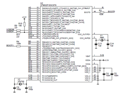

2025-02-10 10:00 AM
So just look at the "blue pill" circuit, as an example:
or at circuit of STM nucleo boards:
So choosing 2x 20 pF should be ok; (out of the typical range 12...20 pF)

2025-02-11 7:36 AM
The 2x 20 pF on the nucleo board are for a 8 MHz crystal with 16 pF CL, if i understood that correctly.
Are this also safe values for my crystal?

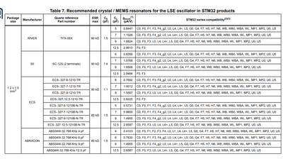

2025-02-11 7:44 AM - edited 2025-02-11 7:51 AM
Hello @Michael_CH ,
The recommended crystals for STM32 are listed in the application note AN2867 pointed out by @Peter BENSCH .
Table 7. Recommended crystal / MEMS resonators for the LSE oscillator in STM32 products:
Its shows the CL of the recommended crystals. I think you cannot exceed CL =12.5 pF.
EDIT: the table was a recommendation for the LSE.

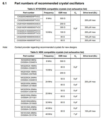

The recommended crystals are provided in tables Table 8 and Table 9:
CL load max = 8pF.
I recommend you to find one of these crystals or find another one similar with the same characteristics
